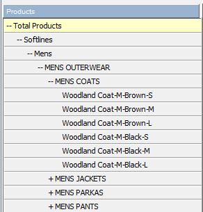

My customer requirement is : display of products under consolition depend on each period of year.
For example : In Q1, product 1 is displayed under consolidation 1.
But when user change view to Q2, product 1 must be hidden, although product 1 is still under consolidation 1.
This is original consolidation
I only want to display some of them, so i remove what i don't want to see. New consolidation looks like this
But when i collapse then expand, the consolidation return to original display.
Could someone tell me way to keep the new conlidation regardless collapse or expand ?
Thanks all,
Tin

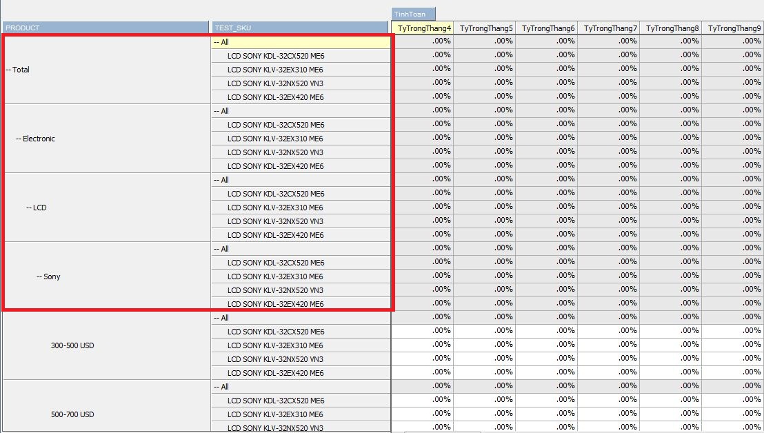

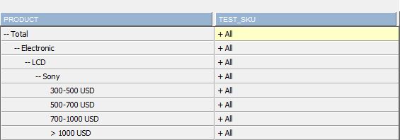

I did separate into 2 dims : Products hierrachy & SKU.
Before expand SKU :
After expand SKU :
1. SKUs for levels higher than Price segment is meaningless (in red area) => how could i hide them ?
2. Each price segment include SKUs depend on SKU's price, but in this case, SKUs in each price segment are identical => how to fix it ?
Tin Pham

phamtinkt88 wrote:1. SKUs for levels higher than Price segment is meaningless (in red area) => how could i hide them ?
The obvious option is to remove those consolidated elements from the subset in the Product dimension. Or, you could try and define an asymmetric view, but unfortunately the Cube Viewer tool in Perspectives doesn't do these. You can do this with Executive Viewer/ Cognos Express Advisor and customized MDX reports in Excel. An asymmetric view is where you can pick and choose which elements in dimension 2 show up against dimension 1 when they are nested on rows, or columns for that matter.
phamtinkt88 wrote:2. Each price segment include SKUs depend on SKU's price, but in this case, SKUs in each price segment are identical => how to fix it ?
You need to zero suppress the view. If you do that you will only see rows where a SKU has a price in a particular segment and all the rows containing zeroes will be removed from the view, i.e. the SKU doesn't have a price in that segment. Have you tried that?

I did suppress zero and this is the result
RED BOX : Suppress zero does not remove SKUs for consolidated node (of course, because it is consolidated data from child node)
BLUE BOX : When i expand All in "SKU" dim, it is expand for each coressponding node in "PRODUCT" dim. The view become very long, but my customer only want to show product for each price segment, after complete one price segment, they collapse it and expand the next one => easy for them to observe.
Thanks for your reply,
Tin Pham
Re: Hierrachy Display Problem ?
phamtinkt88 wrote:BLUE BOX : When i expand All in "SKU" dim, it is expand for each coressponding node in "PRODUCT" dim. The view become very long, but my customer only want to show product for each price segment, after complete one price segment, they collapse it and expand the next one => easy for them to observe.
This is just the way dilling into a cube view works in TM1, there is nothing you can do about it in a view. However, if you create an active form with Perspectives and Excel, you can add some addtional functionality where the user can lock the drill on the PRODUCT dimension (by setting the starting point for the drill in another cell) so that you don't see the combination of all products and SKUs when you drill down. If you use the SUBNM formula in this "Starting Point" cell then the user can navigate the dimension at will to select the starting point. They can select the top of the hierarchy, a middle point, or any child. Here's how it works:
Put this formula in any cell outside the active form range (for example purposes we'll give it a range name of ProductDrillLock):
=SUBNM("ServerName:DimName","SubsetName",Index).
In the PRODUCT column of your active form report make the TM1RPTROW formula look like this:
=TM1RPTROW(CellRefToTM1RPTVIEW,"Servername:DimName","",ProductDrillLock)
Now, users can drill through the entire PRODUCT dimension by going to the SUBNM cell, double-clicking, then navigating in the Subset Editor and selecting "Total", or they can lock onto just "Electronic", or all the way down to "Sony" and the maximum range of the form, when drilled along the PRODUCT and TEST_SKU dimension, will be controlled to just what the user wants to see.
