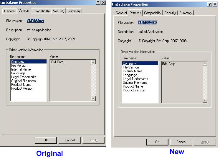

OK, thanks to local support, I've been able to get the information.
It's not actually regarded as being a new release or version, though it does have a new version number. Kinda sorta. Unfortunately one of the cute things about 9.5 is that unlike past versions, clicking on Help / About in Server Explorer won't give you the version, build, etc number, it just gives you a splash screen. (Yay for "branding".) From that, you have no way of knowing which version you're on. As far as I can tell you need to find the .exe file and right click on it to check its properties. In this case the original release of 9.5 was 9.5.0.65077. The new one is 9.5.100.2380 as shown below:

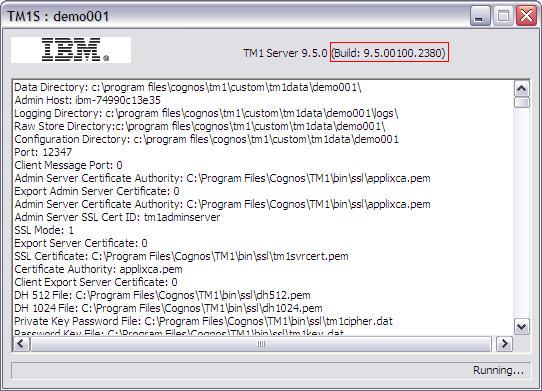

After seeing your post I tried to check the build version of new downloaded and installed 9.5.
In the properties window of tm1sd.exe I have the same 9.5.100.2380 build.
But when I run one of my TM1 servers as an application I saw this:
This maybe is a reason why they still call it 9.5.0, but of course I agree this version should be somehow differed from the older one (e.g. with the FP1 suffix).
